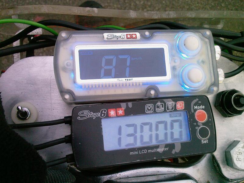

I race with a polini 47mm rv cilinder :^^: the specs of the cilinder are very nice, quality of the polini nicaseal are superb. :thumright:
porttimings;
exaust;
height; 24,4mm timing 180,1 degrees
(i always set the deck @ 0,5mm)
several deck heights ;
0,5 = 180,1
0,75= 181,44
1,0= 182,78
1,25= 184,11
1,5=185,44
blowdown= 30,56 wich means that the max power of the cilinder lays arround 10000 a 12000 rpm, untuned the cilinder wil rev up to arround 12,5 /13.000 rpm
powerband/revs/Hp depends on the exhaust youre using,
i'm using the cilinder on a puch maxi engine ( :P ) and it has arround 14/15 hp.

If you have the same exhaust as me on that picture, don't use it, because this one has a small diameter (i thought 28mm)
mine had an AM6 engine, i've never had this exhaust on 70cc's, but i did have a Zen exhaust on my 70cc, it would go up to 140km/h...
The standard Exhaust is a AF1 Futura Exhaust by the way :P

Yeah the cylinders are good, mine does look almost exactly the same as yours and is a 47mm bore, but might not have the polini writing near the reed valve. as for port timings and blow down etc, i don't know much about this, sounds like you have opened the exhaust port? also this may sound stupid but could you explain what the deck height is,and blowdown?

i'll try to explain in my rubbish english :D:. Deck Height is the space between the piston dome and the combustion chamber, at top dead center (TDC).
blowdown; the amount of TIME between the exhaust and transfer port openings
( http://www.muller.net/mullermachine/docs/blowdown.html )
Not very important if your not planning to tune the cylinder, but it comes in handy if you want to know the specs of a cilinder, and with that specs you can ask someone over here if its a good cilinder or not, and how it performs. :^^:

Thanks for the help i now know what they mean, how do you measure the deck height and blowdown? because the specs you have on your cylinder seems to get you good power and revs and i just wanted to see if i could do something like that.
ma jul 21, 2008 7:49 pm
just measure it with a calliper rule! :^^:
read some stuff on the internet about tuning or get a book about 2 stroke tuning,

Thanks for the comment on the bike, i prefer that colour of that style of af1. I think you're probably right about the exhaust, i took the exhaust off today and measured 28mm on the part that goes in the cylinder but it is a tight fit and a 32mm exhaust wouldn't fit the cylinder. so how would i fit a 32mm as i thought all performance/fast exhausts for rs50's were 28mm or had adaptors? Thanks for the help.
di jul 22, 2008 8:13 pm
28mm is just fine, that would'nt stop the revving. the problem is the expansion.
try to find a gianelli or a yasuni exhaust :^^:
